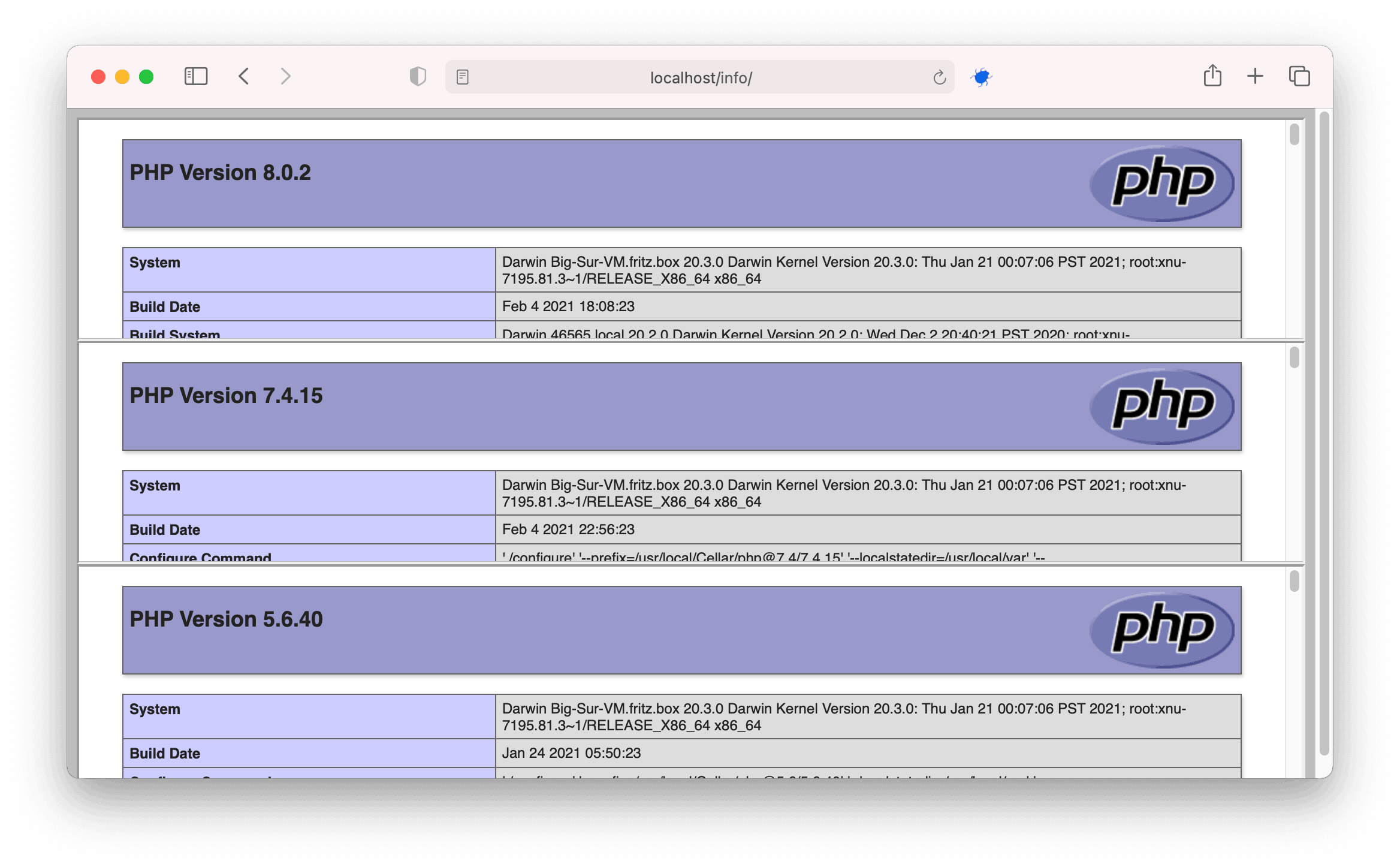

Selecting a PHP version
This is the clever part. We can instruct Apache to pass PHP scripts to any of our installed PHP versions with a little configuration in a .htaccess file.
The configuration we built above will default the server to use PHP 8.0, but it's easy to override this on a directory by directory basis.
In your Documents/www folder, create the following tree of folders and files (or download this zip, which contains the same contents):
  • Documents
    • www
      • info
        • php5.6
          • info.php
        • php7.4
          • info.php
        • php8.0
          • info.php
In each of these index.php files, add the following contents:
<?php
phpinfo();
If you visit any of these locations using your browser, you will see PHP 8.0 reported as the version in use.

With those files in place, refreshing the PHP info pages for any of those PHP version directories should show the correctly-targeted PHP version. Any PHP files served from those directories should also use that same PHP version.
You can now liberally sprinkle these .htaccess files across your www directory to have any directory select any version of PHP you choose.
Screenshot: Three versions of PHP running concurrently through the Apache webserver

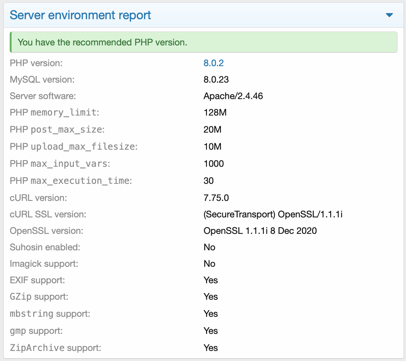

It has been pointed out that MariaDB does not work particularly well with CJK languages. If CJK support is important in your development process, you should replace commands referencing mariadb with mysql, which will cause MySQL 8.0 to be installed instead.
Specifically, the commands that should change are:
# install packages including MariaDB:
brew install pkg-config mariadb httpd mailhog imagemagick elastic/tap/elasticsearch-full shivammathur/php/php@5.6 shivammathur/php/php@7.4 shivammathur/php/php@8.0;
# install packages using MySQL instead:
brew install pkg-config mysql httpd mailhog imagemagick elastic/tap/elasticsearch-full shivammathur/php/php@5.6 shivammathur/php/php@7.4 shivammathur/php/php@8.0;
# start MariaDB service
brew services start mariadb
# start MySQL service instead
brew services start mysql
Screenshot: XenForo admin control panel reporting MySQL installed instead of MariaDB
