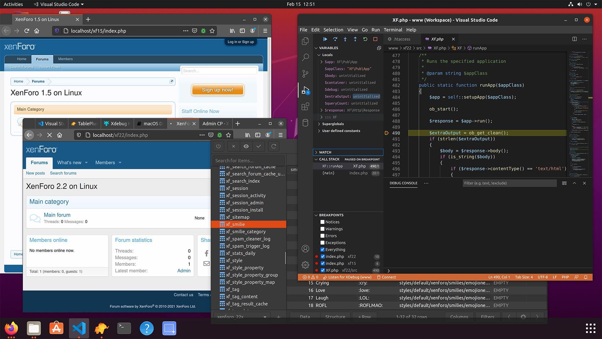

Screenshot: Ubuntu Linux running XenForo, being debugged by Xdebug with Visual Studio Code

Screenshot: Three versions of PHP running concurrently through the Apache webserver
